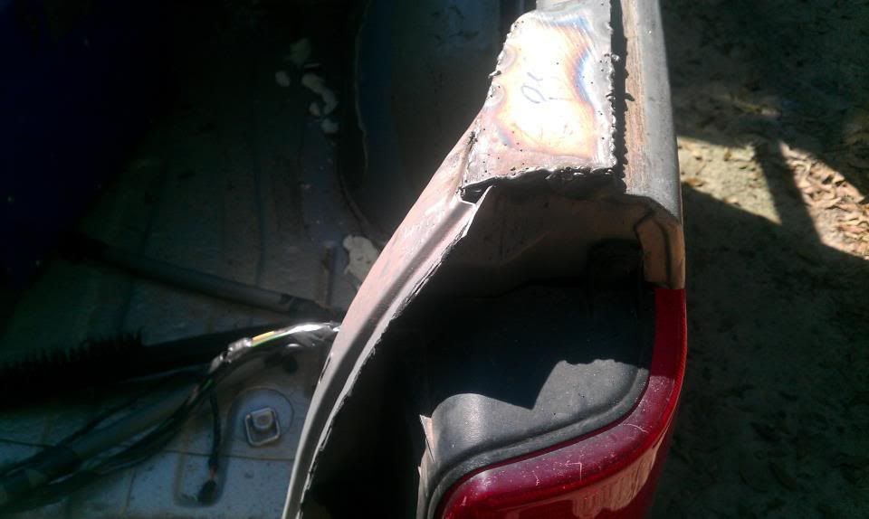

Post by 4x4troy on 9/24/2011, 5:21 pm
i used the roof rails to make side panels to fill the gap between the hatch and roof shell. works pretty dang good. the rear d-pillars were capped also with plate steel. everything with get welded and glassed in.

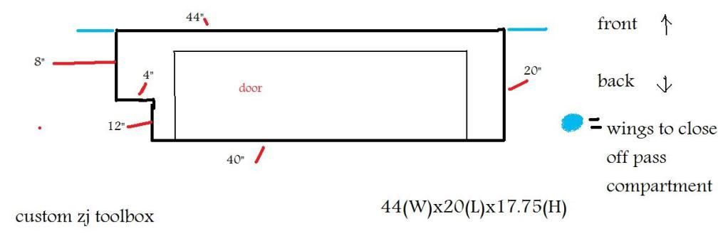

Post by 4x4troy on 9/27/2011, 1:54 pm
yes i like the tool box idea too

Post by 4x4troy on 9/27/2011, 6:31 pm
the design of my toolbox....
