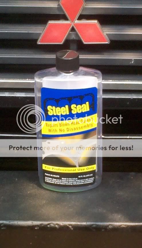

Post by MudRaider on 4/11/2012, 4:02 pm
Still working great. No water loss, power is up.
Here's the bottle it came in. Still amazed.
